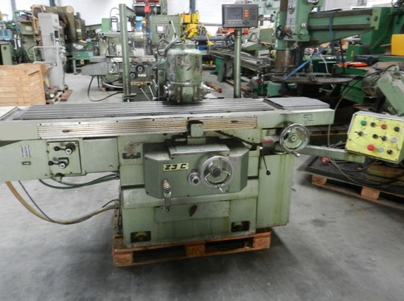

Hello Peter.
This machine isn't very common. Even in France. I have never seen this kind of machine.
E&S Z3C and E&S ZHV3 are common machines. But they do not have CNC. And they have a quite  different architecture.
HES Ernault Somua Z3 PNVN VrlmZ
If you want to search with a reaserch engine, the right name of the machine in France isn't "moulin". Moulin is a machine used for grind flour... In French milling machines are named "fraiseuse."
Good luck for your researches.

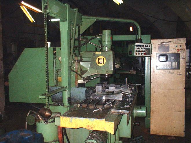

The Raffy company has a H. E and S Z3 with NUM 560 numerical control.
HES Ernault Somua Z3 PNVN Yl98P
NUM 560 is an old fashion device. But many machines are sill using it.
http://www.raffy.fr/fichiers/equipement.php
NUM was a french company wich has produced many numerical control equipment. You can probably find a NUM 560 owner handbook on Internet.
If not, maybe Raffy company has the handbook.
Maybe, your machine was sold by Ernault-Toyoda a Joint-venture between the french Ernault-Somua and the japanese Toyoda (Toyota group.)
In the 80's, the french government decided the "MachineTool plan" This plan included the numerical control maker NUM as supplier for all the french machine tool makers. It was an enormous error. NUM CNC were quickly overtaken by the competitors and the french machine-tool industry was penalized by the choice of the french government.
A few years after, Ernault Somua and other companies  became SOMAB.
Now SOMAB is owned by the CATO group. Cazeneuve, Cincinnati, Syderic are in the CATO group too.
http://www.somab.fr/pages/historique-hes-ernault-somua/
