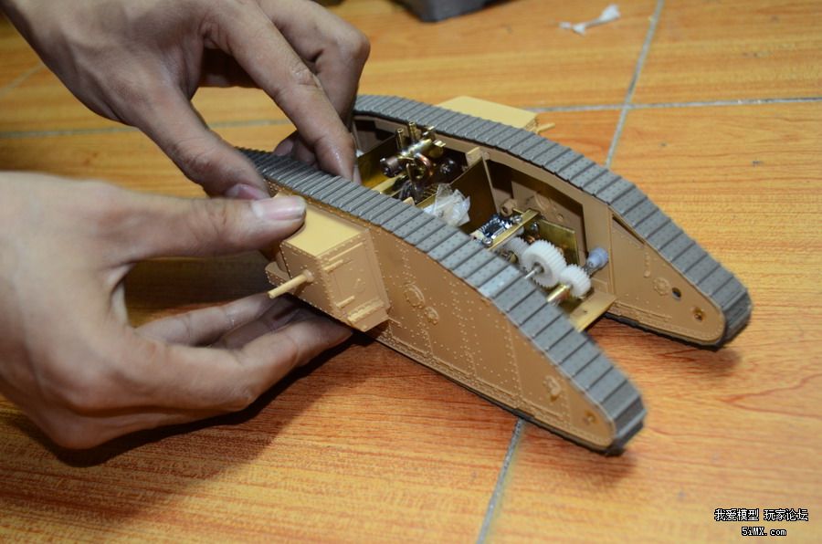

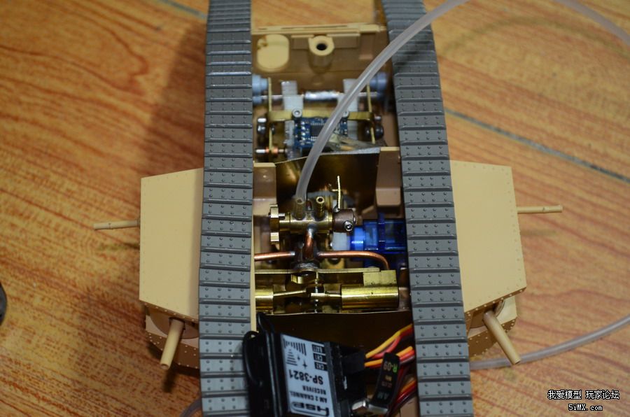

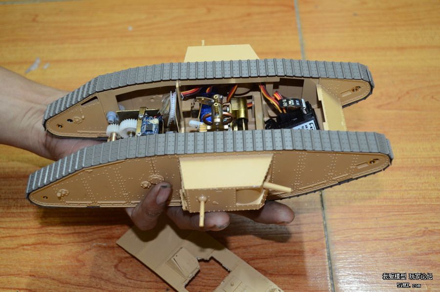

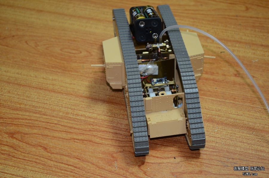

Original belongs to electric tank, through a series of modifications. Use a mini four-cylinder steam engine, the engine can be
self-starting. Achieve throttle control, forward and backward. Gearbox thick plastic gears. Focused on reducing gear reloading
and dry sound. Shift selection of mini linear servos.
Space vehicle body can use is very limited. Steam boiler planned external fuel with gas heating.
